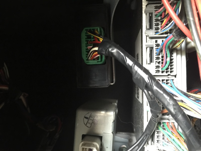

The first thing you’ll need to do is locate the wire that goes from the 4WD module, to the ADD.

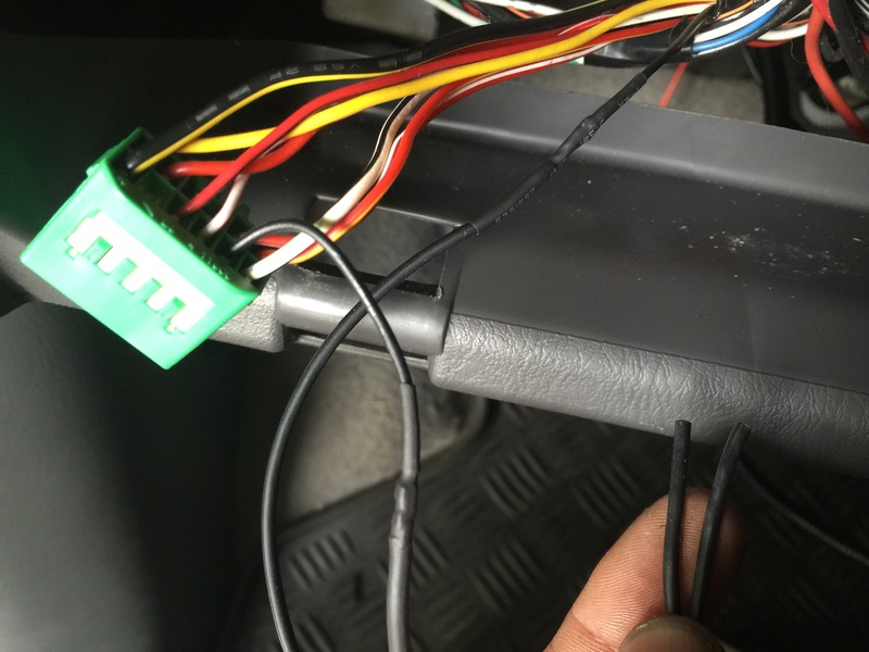

Remove your glovebox, and you’re looking for the thin black wire coming from the green plug in this picture.
Cut the wire, extend both sections as much as you need, and connect these to your switch/relay.
You’re done!

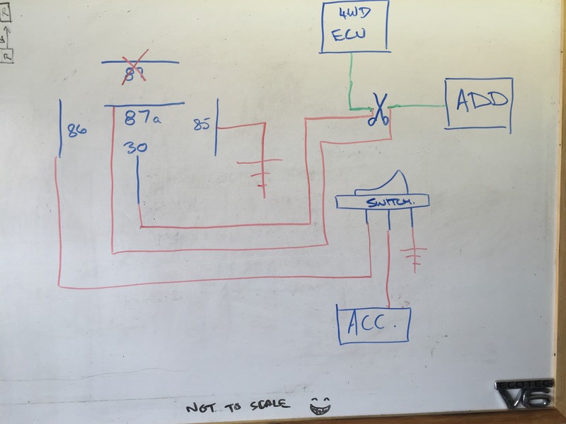

A relay is only necessary if you want a switch with a light to remind you that you’ve disabled your front diff. If not, you can just use a simple switch.
Note: The relay needs to be a ‘normally closed’ type.
Here’s a diagram to explain how I did it.
This post has all the info you should need to complete this mod yourself, but it is very brief, so if you have any questions, I’ll do my best to answer them.
